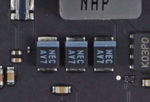

One capacitor on my MacBook Air 2013 is defective and I need to replace it. It’s code is NEN AV7.
I found a new capacitor but with code NEE AV7. Can I use it to replace the defective one?
How about posting a few pics, one the area and one zoomed in on the cap in question so we can try to identify it from a boardview drawing.
Also, is the system working currently or not, as well as if you are having any difficulties.
@danj
The component on the logic board 820-3437 is indicate as C7143.
It’s part of PPVBAT_G3H_CHGR_REG.

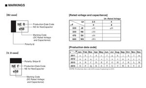

The capacitor C7143 (coded on the surface as NEN AV7) has the following characteristics: 62uF, 0.023 OHM, 20%, 11V, tant-poli, case B2S-1.
My question is if the NEE AV7 which I found has the same characteristics. I believe so, but I’m not sure
You have the correct values so you should be fine.
Here’s a link to the product guide NEC Token Tantalum Caps
Here’s the breakdown of the codes for these caps
So…
NE = NeoCapacitor and the Letter C = 2013 date code
AV7 - is the value of the capacitor
Clear.
