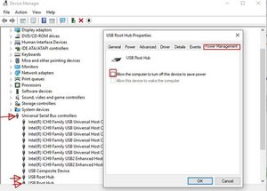

Is the USB port physically damaged or just that it is not supplying power to the connected device?
If it is just not supplying the power check in Device Manager > Universal Serial Bus Controllers > right click USB Root Hub > Properties > Power Management to ensure that the checkbox that says “allow the computer to turn off this device to save power” is unchecked. If it is checked, uncheck it, click OK and then restart the laptop and see if it now works.
Here’s an example of Device Manager to show what I mean. You may have to check all the USB Root Hub entries as I don’t know how many are listed in your system or which USB port they are associated with.
To get to Device Manager, right click on the Windows Start button on the left side of the Taskbar and click on the Device Manager link.
(click on image to enlarge for better viewing)
