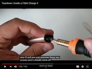

Where can I get a tiny screw driver to undo and then clean the latch on the side of my Fitbit? Alternatively where can I find a repairer to dojo ?
Hello Terence
As you can see in the following picture, you will need a Torx-t3 screwdriver.
You can order it on this site or in any other hardware or electronic components store.
https://eustore.ifixit.com/products/t3-t...
