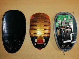

How to I break down a Logitech M600?
The Logitech M600 has no visible screws, and none under the slidey things.
Does anyone know if it’s safe t just work a blade around the top and prise it off?

I think there should be one screw holding.
Most probably in the battery compartment, under the label
I noticed in the pictures of a review for it, there is a little compartment of space next to the battery compartment that might have a screws inside it. Get a flashlight and look in those small side compartments next to the battery compartment.

The surface is glued. Use a hairdryer. Two of the three screws under the sensor
That's brilliant! Thanks. I am really glad that I didn't use brute force and ignorance. Clearly I would have stood a good change of killing it forever.
