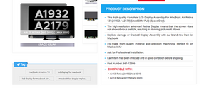

The guys over at MobileSentrix are selling THIS:
So who the !&&* really knows?
@jules420 - To clarify this is just the raw LCD screen which if you have the skills on disassembling of the lid you can in fact replace the LCD screen!
So this is correct, just not very clear in their description! Keep in mind it's a bear of a job. As you are not altering the lid hardware or the camera you can do this!
Most folks stick with the assembly which is different between them! The metal lid is machined differently between the 2018/19 and 2020 as the Magic Keyboard (Scissor) is higher than the original Butterfly. Then Apple intro'ed TrueTone which altered the camera and its light sensor and its logic as well as the signals coming from the lid assembly to the system. So a 2018 display won't work on the 2019/20 systems.
