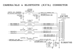

Are you sure the camera is working?
Here’s the other side connection verify the lines
PP5V_S3_Camera is the positive power line (Red) and the frame ground (Black) is the negative side. Do you measure power?
Thanks for your reply! So apart from these 4, I do not need to connect the other wires?
They are the microphone lines (analog) unless you have a DAC to convert the signal you can't use it.

You can find the correct pin out of the board and just match it to the standard USB Type A pins
