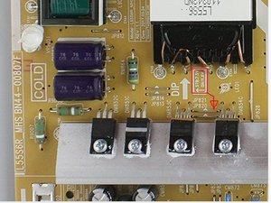

My samsung UN49MU6290 TV will not power on and will not show a standby light. I replaced both the power board and the main board. When I disconnect the cable going from the power board to the main board then the backlights will turn on. I checked the voltage from the power supply and the chart says it needs to be 12V and when I have it disconnected from the main board it will show the correct 12v but when I have it connected to the main board it shows 9v. I am not sure what to do next.

Searching for a Samsung UN49MU6290FXZA power board, shows that the power board is a BN44-00807F. On the board it shows that the Standby voltage is 7.5V at the test point which should change to 11.8V when the TV is on.
Where were you measuring the Standby voltage?
The 9V measured with the mainboard connected may be a bit high as the mainboard needs to have the correct voltage from the power board to turn on the Standby light. The 11.8V is ~12V which may be close enough.
Did you check to see if all the voltages were actually getting to the mainboard, by measuring them at both ends of the cable? Since you have replaced both boards it may be a problem with the cable between the two boards. Just a thought.
(click on image to enlarge for better viewing)
Apologies if the board number in your model is not the same as shown above and the voltages may be as you say.

Alright so I first checked the stand by voltage from my last post. I went and checked the voltage on the pins from the connector and it still 13v when the power board is disconnected from the main board and it still shows 9v when they are both connected. I also tested the pins on the cable itself coming from the power board and the cable is working fine. I will attach a photo that shows the voltage chart next to the power board connector.
