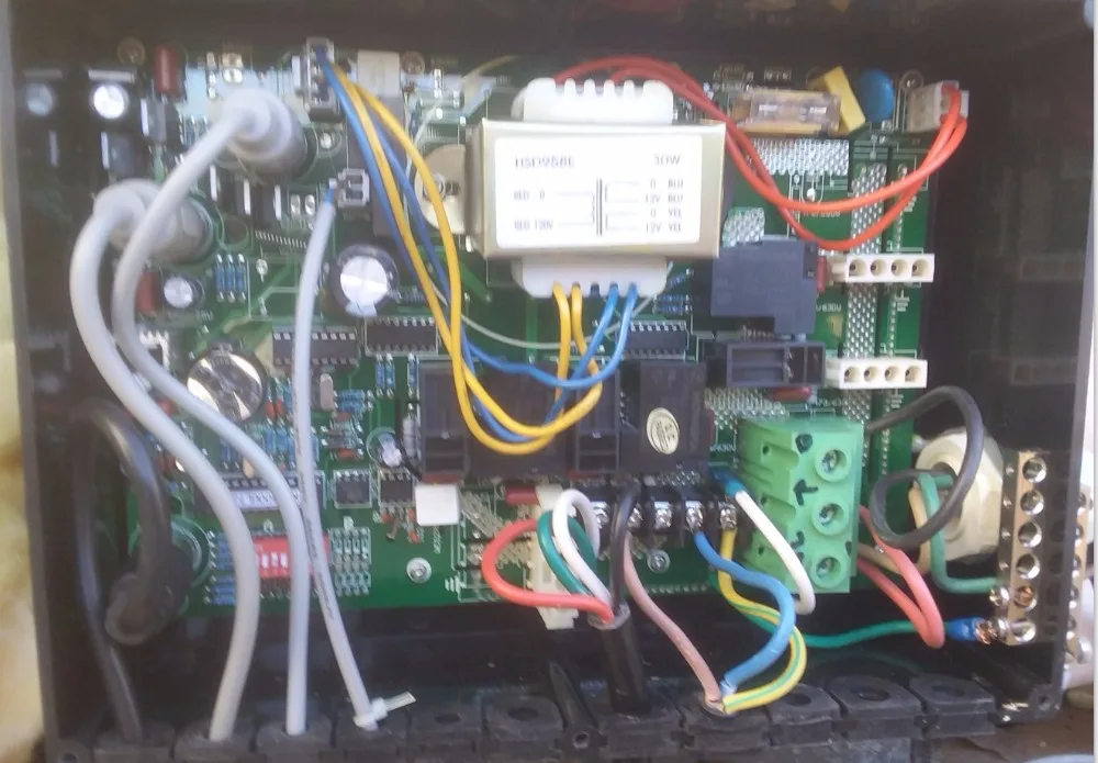

i bought a new energy saver spa pack for my hot tub , everything hooked up but i can not get the heater wires to connect properly it don’t plug it there are screws for it , the wires on my heater are green and yellow , blue , and brown i am unsure the order they should connect on my spa pack it is a 110 plug and play hot tub please help i would like for it to heat as well and just work. thank you
Update (06/07/2020)
Here are pictures of the wiring and where its suppose to go help me figure it out
I posted 3 pictures please tell me how they go thank you
They did not make it easy, did they. I believe the hook up may be under the pale green plastic piece with the 3 screws. Our that is where the house power comes in. But I'd like to be more certain so I don't suggest anything that could damage the heater.
Could you get a wider shot of the circuit board, preferably of the whole board and showing where the power cable to the house power connects to the circuit board?
It would also be very helpful to get a picture showing the circuit board at the base of the pale green plastic piece with 3 screws.
Finally do you have the name of the company that makes or sold the energy saver spa pack, and the name or model number they sell it under. For exmample a KL6500 pack bought from EnergySaver Spa eqiupment. I may be able to find a wiring schematic for it with this info, In the mean time I'm looking through anything I can find called an "energy saver spa pack" in 110V to see if I can match the curcuit board part you show.
By the way, if you are thinking this shouldn't be this hard, you're right. On my spa control board the heater terminals is clearly marked, But we'll figure it out.

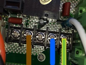

EDIT: I updated my answer and included a picture showing what I believe to be the correct wire attachments. It is modified from the one you provided so it should be very clear as to what goes where.
Wow! I think I may have found your control board for sale on Aliexpress. It is a replacement for a KL6500/KL6600 board. If it is the correct board and it looks like it, it shows the heater attachment. A picture of it is at https://ae01.alicdn.com/kf/HTB1PZPCi3LD8...
There is even a schematic of the wiring. I can't seem to get a direct link but it is the last of the four images for the product here:
https://www.aliexpress.com/item/32846426...
Which means you hook up to the set of 5 silver screw terminals in your 3rd image. I modified it to show the correct attachments and added it to my modified answer.

EDIT: Updated with new information about where to attach wires

With that out of the way, here is what your wire colors mean. The brown wire is the hot wire. In household 110V AC wiring, it is the black wire. The blue wire is the neutral wire, the same as the white wire in household 110V AC. And the green/yellow wire is the ground wire. It is the same as the green or bare wire in household 110V AC.

And lastly, here are what I believe to be the correct connections based on a matched board being sold on aliexpress and the associated connection schematic.
