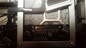

I have a 27” iMac 27 that one of my coworkers has damaged the display connector while pulling the LCD hard and snapped some pins from the board.
This was done while I was replacing a hard drive that failed. "Common thing with the iMacs."
Before coming here I have Googled the problem, read so many forums and found a post in Macrumors.com, where people had this issue and fixed it by ordering a new connector and soldering it on.
I went ahead and ordered that connector, when i got it I quickly start soldering it. Unfortunately it is a bit challenging and spent days to get right without bridging it, but it is impossible.
I have become so impatient that I want to throw the whole thing in the garbage, but I have got so many video projects to do being a video editor.
I want to know if other people are experiencing this issue, and how to they dealt with it. Also if there are anyway repair places that I send the logic board and they fix it for cheap, I know how much Apple is demanding and I just can't afford that.
Thank you in advance for any replies.
I have attached some photos for reference:
Dedicated GPU
The solder joints
The part

The same happened to me on my out of warranty iMac 27 when I was replacing my defective super drive with a blu-ray player, where I lost a pin on the right side, and on the left side, eight pins were pulled off along with the left most pin pulling off a pad, and part of a trace.
I have not soldered anything since I was a teenager, and I definitely have no experience soldering SMT, so I watched, and studied a lot of video on YouTube. This made me want to get back to my old hobby, but I have no equipment!
I ended up buying a new connector from L2 Computer Inc on eBay, Aoyue 968A+ 4 in 1 Digital Hot Air Rework Station along with a bent nozzle from SRA Soldering, solder paste from Zephyrtronics, schematics from NotebookSchematic, microscope from MicroscopeNet, and a meter from a local electronics store.
When I got my equipment, I did some practice soldering on a practice board, gaining some experience on how the hot air soldering work, and how the solder reacts, figuring out the correct temperature to use.
I used the schematics to figure out where the replacement trace should go. To replace the torn trace and pad, I used one of the pulled pins, and shaped it with needle nose plyers. I applied soldering paste onto the pads, and improvised trace/pad. For those pads with pins attached, I pulled out the corresponding pins off the new connector, and then slipped the new connector on. Using the Hot Air rework station, I used the hot air to solder the connector back on, and the soldering iron to solder the two ends back onto their respective pad. I then used the meter to make sure all the connections are correct according to the schematics, and touched up with solder paste, and hot air where ever the connection was not good, especially my improvised trace fix.
I was successful, and typed up my experience with my fixed iMac 27.
I probably spent more than what it cost to ask someone else to fix it, but cheaper than buying a new logic board.

Using hot air to re solder the connector is a bad idea you can easily melt plastic inside the connector pairing pins then you have bigger problem. You should invest in a fine tip for the iron and decent magnifying glass , with plenty of flux and pre tinned pads you should be able to heat on top to bind on bottom. Hot air to get it off ,unless it's off already and drag soldering to get it back on.

@cecibass - No! The ends where the connector is fixed to the logic board is the only safe place. Frankly, replacing the connector alone takes me 10 minutes to do which is by far the better fix. Even if some of the pads are damaged I rarely get it going with a few patch lines.

I think you're a bit confused! There is two sides of the connection the cable end and the logic board end. In most cases the logic board connector gets damaged. And Apple does not offer discreet parts for the logic board.
