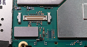

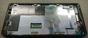

Anyone knows where to locate the backlight fuse on a XZ2 Compact; Help greatly appreciated
Hi, I had destroyed my backlight of the XZ2 compact by slipping off with a tweezer during display change. I solder a 0402 zero resistor, because I have no fitting fuse and no time to order one.
