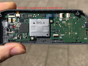

I Have the same issue with my right joycon after changing the flex for the L & R buttons. I am a total noob and touched the battery connector with the tip of the metal twezers. After some fault finding with a multimeter i found a short on one of the capacitors. I cant find any documentation on the surface components ( specially those unmarked capacitors) . If anyone can help we can bening to figure out what happend.

Update (02/11/2021)
FINALLY!!! found a solution !! It turns out the reddit forum was right. There is a “resistor”?? that protects the rest of the board when you touch the battery terminals. There was a comment that i decided to try . Now ….. This was EXTREMELY difficult to me and i think in the end it was pure luck that i manage to do this with my tools.
I just bypassed the resistor with a blob of soder. and that is it . Joycon came back to life.

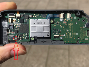

2 years right controller used only connected to console, not charging at all. Small drop of solder to this little bastard on picture below and now joy-con work perfect.

However, I can confirm (in my case) you can literally just drop a blob on top of the resistor (or fuse, not sure what that is exactly), enveloping it.I believe it will just bridge the connection right over the fuse.
As an aside, in reference to the post about the battery splicing solution, if your solder bubble is too big and covers the pad mentioned in that post as well, this is fine. That happened to me and I couldn't risk cleaning it up. But when I tested, even with the blob covering both the resistor and that pad, it now is capable of charging and holding a charge again.
For the definate answer answered by a reddit user. This is the fuse to be bridged or replaced
Hope it helps you all
Was it the resistor that you showed in the pics? To be honest I've not bothered looking again for moths.
Yes, the tiny resistor that is next to the battery connector

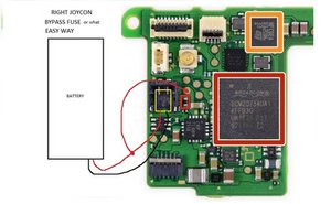

The so called “fuse” is very difficult to bridge with solder or a wire and when I tried it the result was to destroy one end of the fuse making it impossible to bridge. Luckily I found out that one side of the battery(the positive) is connected to one side of the fuse and the other side is connected to a nearby small pad which makes it easier to bridge. I enclose a picture of what I did…hope it helps.
This fix is for the right joycon but I guess the left joycon has something similar which an ohmeter can discover….
it works thx so much

Samer, in the pictures above you will find a high quality one that says "resistor suspected on reddit forum" .
Its the tiny resistor just next to where the bttery connector is.
