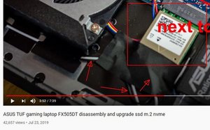

Hi,
If the WiFi connection keeps disappearing but the WLAN adapter’ status is still OK in Device Manager when there is no connection, try placing the laptop as close as possible to your WiFi router and check if the connection stays on and is stable.
If the WiFi connection stays on, then it may be an antenna problem.
Here’s an image taken from a teardown video of an Asus FX505DT that shows the location of the WLAN card so that the antenna connections can be checked. The arrows show the black and grey antenna cables, going under the tape to the card
I realize that it is not your particular model but I think that the location of the card is the same for all FX505 models.
(click on image to enlarge for better viewing)
How old is the laptop as it seems to be a recent release? If it is not yet 12 months old, get the problem fixed under warranty, as opening the laptop will void the warranty.
If the WiFi connection still drops out, try operating Fn + F12 to first place the laptop in Airplane mode and then operate them again to see if the WiFi is restored. Just wondering if it is related.
You could also download, install and run this free WiFi sniffer program to check the signal strength of the WiFi signal received by the laptop. If it stays fairly constant but the connection is lost then it may be a software problem. Remember that the signal strength values are -ve (negative) dB values so the higher the number the weaker the signal.

If it is only able to connect very close and not when its anywhere further that usually indicates a problem with the antenna cable / connection. Could be unplugged or damaged antenna cable.
My guess is the antenna cable has become unplugged somehow, good to verify but opening the laptop will most likely mean warranty void.
