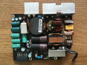

When you disconnect the AC cord you are loosing the vampire power the system requires to hold the PRAM settings, so the small Li-Ion button battery is used. What happens here is the battery is worn-out from age and lack of use! So the system looses its settings. But, when you plug in your system again and let it sit for awhile there is enough power leaking to the battery to give it a bit of a charge (not designed to charge though) so the settings become available after awhile, this only lasts a few times before the battery can’t be charged anymore.
Time to replace the battery! Follow this guide to get to it iMac Intel 24" EMC 2267 Front Bezel Replacement. You’ll find the silver disk button battery in the bottom right corner near the speaker - 3 volts BR2032.
The other possibility is the Power supplies capacitors have failed do to Capacitor Plague that will require a new power supply iMac Intel 24" EMC 2267 2.66, 2.93 & 3.06 GHz Power Supply

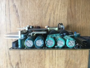

The replacement battery doesn't seem to fix it. This morning the iMac worked again. A few hours ago I 'transplanted' it again to a different socket, and now I'm again waiting for the power LED to come on. I'm curious how long this will take again.
@milvo - Time to check the power supply caps
This is what they look like. They don’t look damaged to me? How do they look to you?
