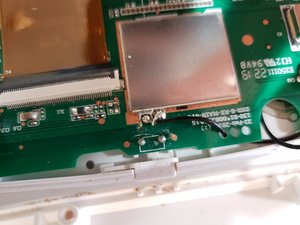

Desolder the antenna from the mainboard.

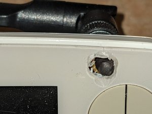

Remove the broken antenna parts from the casing.
Fit in the new SMA connector, you might need to drill or work into it.
and solder the pigtail end to the mainboard.

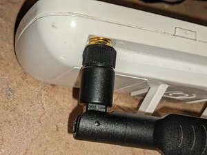

End product should be like this as an example.
And you connect the sma antenna to it.

The trick to making this work is to connect both the inner core of the wire and the shielding (outer conductive layer) to the respective spots on the board. Usually the shield is grounded and the inner core is the connection to the antennae. If you buy the amazon linked antennae above it is easiest if you remove the small snap-on type connector. If you pry up the two edges it pulls right off leaving you with a tiny wire in the middle and the shielding exposed. They are separated by an inner jacket. It was the perfect length for me to use the existing solder to attach it. Here are some pictures to hopefully help. Thank you to all who previously posted, saved me a bunch of money.
#1: snap-on type connector with two edges pried up.
#2: soldered to the board. Be mindful that you need two separate connection points. If solder bridges between the two or you only connect the inner core your range will be severly impacted like the above person said.
#3: zoomed out showing connection and wire placement.
#4: The SMA connector is too long to use the existing hole (couldn't close the case), so I used Sugru to hold it a little further outside of the case.
#5: with the antennae connected. It does stick out the back a bit and can't lay flat, but I use it with the kickstand most of the time so no big deal.
It is a bit heavy opposite the kickstand, so it tips over easily. I've been using the antennae as a stabilizer. I would consider orienting it differently or positioning closer to the kickstand if I did it again.
Thanks for the tip about the sugru. I used JB plastic weld to build up the shell and used a drill bit to counter sink the SMA connector. This left plenty of room to close the shell. To solve the awkwardly large antenna from the original link, I purchased a 2.5 dbi antenna that is much smaller and doesn't sacrifice much distance. It still covers my whole house. And I still have the large antenna if I need the additional coverage. Here is a link to an image of my repair. https://ibb.co/rHVTKFC. Anyway. Thanks for all the effort.
Appreciate the prior tips - very useful.
To deal with the long SMA connector, I drilled a hole in the front of the case to make room for it.
Works like a charm.

could you send a pic of the mainboard after changing the antenna? I noticed that the antenna brown cable is connected to two parts on the main board
thanks in advance!
Hi @winz ,
This is normal for antenna cables
Usually antenna cable have a metal shielding wrapped around but insulated from the inner conductor. The shield is then covered in insulation. The shielding is used to reduce electrical interference to the signal received
Here's an image of what I mean. Outer insulation - metal shielding - insulation - inner conductor
If you take off the clamp you may find that the inner conductor is soldered to the board but the clamp is actually only touching the shield and not the inner conductor

I just soldered it to the ball inside the white box, the lower red arrow in your photo. No need to cut any wires.
