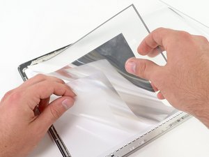

While not overly hard you will need to replace the entire display assembly as the display in this series is fully sealed! The area where the moisture was is in fact behind the LCD panel within the light dispersion sheets. What you are seeing is what was in the water after it evaporated. Your drink was not pure H2O it was made up of tea, sugar, lemon or milk all of which are solids and even the water used to make the tea have minerals dissolved too!
Here’s a view of what makes up a MacBook Pro retina display sheets:
“Diffuser and prism films evenly spread the light to create an even backlight for the display panel. A stationary polarizing sheet then works in conjunction with the liquid crystals to block or allow light for each pixel”
Basically, the liquid wicked up between the sheets.

1 - Yes you can take the display assembly off but what then? Can't open it to get to the staining. Dipping it into distilled water won't help as you are assuming the water will find the same pathway your tea did and even if it did all it will do is spread the mess as the dilution won't remove what's in the water when you force the evaporation again. It just will be a thinner coating over a larger area. And as you are now using a lot more water you have a lot more the dry out. You really need to mop up the water before it hads a chance to evaporate, which you can't.
2 - Blowing air won't get between the sheets where the deposits are and the spots are now dried like paint air won't move them. Even the force of a jet engine won't change things here.
