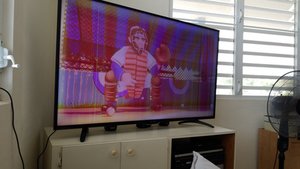

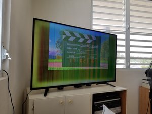

Sharp Roku TV LC-55LB481U. The TV was working fine. My wife turned the TV last Thursday and it turned on with these vertical lines. There was no problem with the TV before.

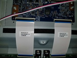

I opened the TV, I checked all the board, I saw no burns on cables or anything bad. I reseated all cables to no avail.

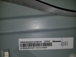

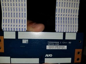

I replaced TCon, but TV still does the same thing. Can it be a bad main board or something else like the power supply or the actual panel?

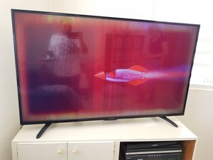

When the scene is dark, the lines kind of disappears but as soon there is white info on screen lines came back again.
Hoping you guys let me know were to start with it.

@cvilleban that looks like a bad panel/LCD driver board which is part of the panel. If you can find a cheap main board you could try and replace that just to verify this but from what your images show, this appears to be a failed panel.
Ok. I ordered the main board to see if this fix the problem. Sad to think it could be the panel, because nothing has happened to it, not hits, no water, nothing.
