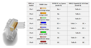

I will take EIA-TIA-568B wiring as a guide. which I do normally.

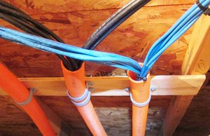

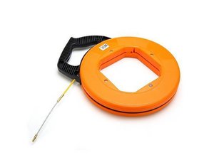

If you lay all by yourself, there are some consideration, best if the backbone cables are concealed inside conduit, to prevent rat bites, and misc. You might also need a fish tape puller to push and pull into.
Conduit - Metal is best but can be costy, another alternative is use plastic.
Fish Tape

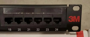

110 (One-Ten) Patch Panel at the termination point.

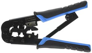

Proper crimping tools
I personally prefer this, to others, and punch tool.
I suggest you get some of the yellow one as it is not so expensive, also handy to strip wires and punch to keystone.

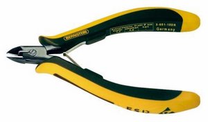

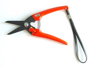

Good wire cutter or garden pruning shears,

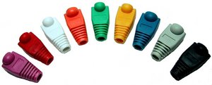

Network cable “boots” to relieve strain stress on the cables end.

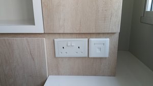

Some Examples of other user work done
Blueprint
Room
Termination point.
Keystone crwdns2934231:0crwdne2934231:0
