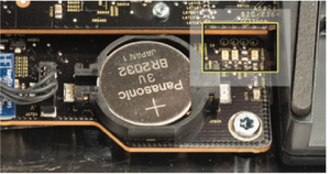

I recently bought my first Mac, a used iMac 2009 model. I can fix Windows PC’s myself.
My mac is not booting up. I hear the chime. Then a white blank screen for few minutes. Then a black blank screen with a cursor. Thats it! It remains there.
I tried to reseting SMC & PRAM. I did not get any response.
I tried to booting from USB, Nothing! no response at all.
Please help.

The first think you’ll need to do is see what the onboard diagnostics are telling you. You’ll need to remove the front bezel iMac Intel 20" EMC 2266 Front Bezel Replacement. Looking at the boot near the speaker and the PRAM battery (which you should replace) you’ll find the diagnostic LED’s
Here’s a breakdown on what they mean:
LED #1 - Indicates the trickle voltage from the power supply has been detected by the logic board. This LED will remain ON whenever the iMac is connected to a working AC power source. The LED will remain on even when the computer has been shut down or put to sleep. The LED will turn off only if the AC power source is disconnected or the power supply is faulty.
LED #2 - Indicates the main logic board has detected proper power from the power supply when the computer is turned on. This LED will be ON when the computer is turned on and the power supply is working correctly.
LED #3 - Note: This LED is not used on systems that have integrated graphics, which includes all configurations of the iMac (20-inch, Early/Mid 2009).
LED #4 - Indicates the computer and the LCD display panel are communicating. This LED will be ON when the computer is turned on and video signal is being generated. If the LED is ON and there is no image on the LCD display panel, the LCD display panel or inverter might be installed incorrectly or need replacement.
