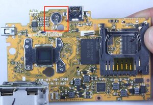

The Easyshare C813’s is on the sensor side of the main board. http://guide-images.ifixit.net/igi/SVOdX...
Unfortunately, that battery looks like it's soldered down. Not a difficult thing to replace once you've got the board out, but removing and reinstalling the board is something that I would not consider easy.

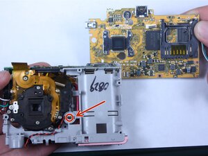

@shamino I'm going to disagree with you; in my opinion that battery does not look soldered in. I believe the metal tab on top of it is kind of a spring contact; the two dimples you can make out are the contact points. Normally I would expect something around the edges of the battery to hold it in place, and it appears there's a cavity on the body of the phone the battery fits into so it'll stay where it belongs, at least in the photo Mayer posted.
Of course the only way to be sure is to take it apart, but that would be my best guess.

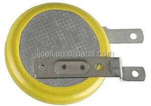

@dadibrokeit: I'm not sure what that arrow is pointing to, but it's not the battery. The battery is next to the USB connector:
There's not enough resolution to read a part number, but it's a small coin cell with surface-mount solder tabs. Something like this:
The "dimples" on the tabs are where they are spot-welded to the battery.
Ah, given that photo I have to agree. The part the arrow is pointing to is a spot with a raised edge on the plastic that's obviously meant for the battery to nestle into. I had thought it also served the purpose of holding the battery in place, but it appears not.
