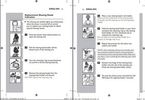

I have one too. There should be a button in the front of the head. Push it. Then push on the blades from the top. Blades should now come out. Put it back in reverse order.
Hi,
Here are some images taken from the user manual that show to to remove/replace the shaving heads
(click on image to enlarge for better viewing)
