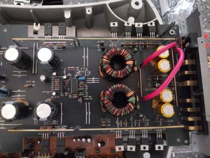

trying to repair this amp need advice
I had this car amp hooked to a bench power supply I alrdy fixed this. Once before cause while in my jeep my son sat on the wires and popped the Amp now after repairing it it work great for better part of 5 years after now I'm back at it again I have tried wiring it with nothing hooked up just positive and negative and it shorts out my bench power supply. So now I'm trying to figure out from the experts where do I start with this issue my last fix I really only changed the noticeable bad and that's what I replaced. Now nothing looks bad
crwdns2942205:01crwdne2942205:0:
Okay to add onto this the positive and ground shorted so I ordered ten mosfets to replace those cause they seemed shorted and two years of work the should be done also
