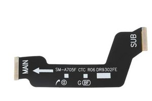

***Replacing Motherboard Connection Flex Cable worked for me solving this problemin more than 10 phones.
So I got my charging issue fixed by just pressing hard on the back of my phone and this seems to be the issue I guess.
If i rplace the Motherboard Connection Flex Cable will it fix the problem of charging ?
@Art avdiu possibly but it depends on what causes the issue. Start with the flex cable and see what happens.

My samsung doesn't charge because of a little metal that is broken on the motherboard, where you put the flex cable that makes the connection from the charging board to the motherboard.
If I put some solder on this small area, will the phone charge again?
