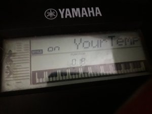

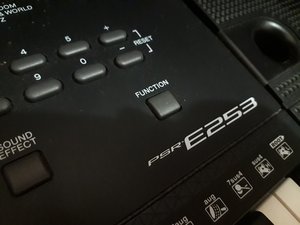

Theres a button that says Function in here.
And if I press on it it’s like you choose something… and theres something called YourTemp….. I pressed some minus sign and it says off but still I don’t know if it.s the tempo function. It still keeps on playing tempo.

Have you checked that the tempo/tap button is not half operated?
If not try tapping the button or the area around the button to check if you can make it come and go.

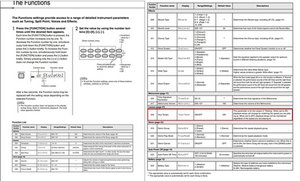

Don’t know the keyboard but have you checked if the tempo function is set to On or Off and if changing this makes a difference at all?

Hi @its_yna ,
Your image of the tempo function shows that it is ON so maybe you have to check the tempo for whatever mode the keyboard is in when it is first turned on, unless you have already done that.
Try resetting the tempo by pressing the tempo/tap button to bring up the tempo value in the display, then press the + & - buttons both together to reset the tempo and check if that resolves the problem.
