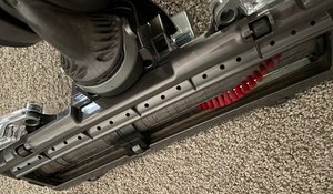

I can’t push my vacuum on the carpet
My vacuum can be pushed on my bedroom carpets but won’t push on living room carpet. I don’t understand. Also it’s making a loud schreaching noise.
I just received my Dyson DC65 Animal Ball 2 vacuum last week. It works great on wood floors and low-pile rugs, but had great trouble on our thicker pile carpeting. The brush head would suck so hard that it created a seal against the floor and became impossible to move.
After reading various solutions on line I called Dyson and they agreed to send me a new sole plate for the brush head. In the mean time I modified the original one in a simple way, by drilling a series of 1/8" holes through the sole plate, along the curved face behind the brush. This allows more air (and dirt I suppose!) into the head and the brushes still go fairly deep into the pile to pull out deeper dirt. This is precisely what I wanted, and it would be easy for Dyson to provide alternative sole plates to customers with thick pile carpeting.
This is by far the best solution I have come across! Will be doing this when I get home today, I've been trying to find ways to adjust the height all along.
I bought the Animal 2 Origin and immediately noticed that there was an issue as it was impossible to push as advertised. After trying the buttons several times and exhausting my upper body pushing, I took to the internet. I read several different things and checked the alignment of my filter (not the issue), didn't want to drill holes into the rubber gasket just yet (doesn't this null in void the warranty?), but thought if I could compress the rubber so that more air flowed under the head, maybe that would fix. I attached 2 long zip-ties to the head compressing the rubber gasket and although one comes into contact with one of the bristles, I can vacuum better on various carpets and hardwood. Just wanted to offer another idea out there. Thank you for your photo of the holes drilled...I'm considering it.
I tried the zip ties today and it worked.
Zip ties worked great, thank you!

The screeching noise could be a bad belt. The belt attaches to the motor and spins the rotating brush head. Hard to say without make and model.
Not sure why the performance would be affected in different rooms. Is the vacuum height adjustable? Could be thicker/taller carpet in one room vs. the other.
