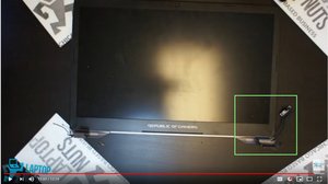

There is also (maybe) unrelated issue with weird malfunctioning columns of pixels on the display. For some time now, there has been a single column of weird looking pixels (not dead, just displaying wrong colors) at the left side of the screen (right around the left lid hinge), which randomly appears and disappears. Right before the hibernating issue started to manifest itself, the column became quite visible, about 10-20px width, but then most of them slowly disappeared and just a single line of pixels that still comes and goes randomly remained this way. Maybe this points out to the issue being with the GPU and not the sensor? Am I right to assume, that in the case of the dying GPU, it would require a full motherboard replacement, as the GPU is probably soldered to the motherboard without possible hope for an independent replacement?

With regards to the intermittent pixel problem ,it may be a loose video cable connection or perhaps a damaged cable where it passes through the lid hinge. Worst case is if it is a panel problem i.e. a loose connection in the panel itself
Try slowly moving the lid back and forth or apply some pressure to the hinge (not sure which one, left or right)to see if you can make it happen.

You were right about the lose connection in the hinge, applying a little pressure to the right lid hinge seems to fix the problem.

Back on the pixel problem, here’s an image taken from this teardown video of your laptop that shows the cable passing out of the right hinge.
(click on image to enlarge for better viewing)
If you decide to follow this up and check if the cable is damaged and find that it is, rather than just being loose, here’s a link to a supplier of parts for the laptop.
