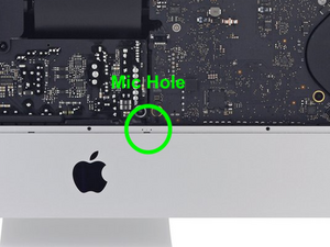

after Upgrading my iMac 2019 the microfon did not work
after Upgrading my imac 2019 the inbuild microfon did not work..
I didnt remember what connector it was ?
have you any idee
Nothing to do with a Imac 2019 27 '' I've found that the problem was the microphone itself, means that it's a HARDWARE PROBLEM.
Just try by using your headphone connected or iPods on bluetooth everythings work. So, i can concluded that it is an hardware problem.
The microphone is well hidden!
What happened is when you put the adhesive strip down you plugged the hole in the case covering the microphone.
Here’s more details on properly installing the display iMac Intel 21.5" Retina 4K Display (2017) Adhesive Strips Replacement
Is this the same with the 5k iMac?
@veenenen - Yes!
In my case i messed up real good.. the microphone in my 27 inches 5k 2019 is broken after upgrading the ssd.
the ribbon is very fragile
any idea how i can find the part?

Did you fix it? I just ordered one from thebookyard.com, hope it works flawlessly
