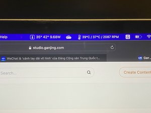

Anyone encountered this glitching/flickering screen on their 15” MBP 2016 w/ Touchbar (see video)?
It seems, the problem appears when I’ve been using my laptop for a very long time (like almost the whole day) and only when I use softwares like Photoshop, Final Cut Pro, or when I’m watching YouTube or streaming videos. But when I close the lid or restart the glitching disappears, before it reappears again after a few minutes. It gets to “rest” overnight. Then same problem when I start using the laptop again the whole day.
Normal computer use, typing and browsing doesn’t seem to make the glitching appear.
I don’t know what this is and it only appears on some occasions. I brought it to an Apple service center and they advice me to observe it for now because they’re not sure if they could reproduce the problem.
I just can’t figure out what’s causing this!

I tried the cooling the laptop when the glitch appeared. It seems like it's not the temperature. It woud reach 51˚C sometimes the glitch would appear, sometimes not.
When it appeared, I tried cooling the laptop down to around 48˚C with a fan and jacking up the internal fan to 4000k+ rpms. The glitch is still not there.
I quit Photoshop and the glitch stops.

I have SMC fan control and I monitored the temps. It's not heat. The flickering happens regardless of the temp. In addition, if it was the temp closing the lid will not (temporarily) stop the flickering.

@danj I already tried this and got my computer connected to an external monitor. Connected to the monitor, the flickering disappears. I also bought TG Pro and this process didn't solve anything. It's true I can control fan speed and all that stuff, but my screen still flicks when the computer performs heavy tasks. This logic board I currently have was replaced completely at the end of last year and I got this issue again just a month later. I took the computer with some videos proving I had an issue again and they told me this was screen related. I didn't go to an Apple Store itself, I went to an Apple Authorized Service Provider because there's no Apple Store here where I live. Let me know if you get any solution for this, I'd like to know if this issue is a logic board problem or a screen problem, thanks.

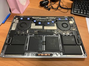

My machine has the same problem:
1. clean the heatsink
2. add some heatsink foam (blue)
3. remove the display cable bracket
After that, I feel good under 40 degrees, the screen also stops shaking
