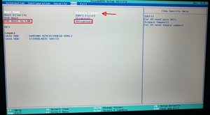

Hi,
Just verifying that the BIOS boot settings are not as shown in the image below?
These options are not there is this correct?
(click on image to enlarge for better viewing)

Hi,
If Boot Mode = Legacy Support what options are available in BOOT PRIORITY when you click on it?
Can you change this option at all?
If you can don't forget to "save" the changes when you exit BIOS.
In Boot Priority: Legasy first and UEFI first. Дело даже не в этом, при любом раскладе, попытках загрузки в свою вторую операционную (не Windows), вылазит ошибка:
PXE-E53: No boot filename received
PXE-M0F: Exiting PXE Rom
Hi,
Is PXE boot to LAN setting in BIOS set to disabled?
If not then if the HDD is detected in BIOS it isn't bootable for some reason.
The BIOS is stepping through because it can't find a bootable HDD and PXE is the last option it tries.
PXE LAN boot LAN is disabled. If a hard drive is detected, what reason could be not loading it?
