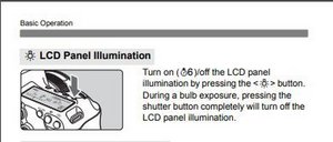

Have you tried pressing the LCD illumination button and check if that “lights up” the screen?
Here’s an image from the user manual that shows where it is located.
The LCD illumination button illuminates the top LCD just fine, but doesn't do anything to the primary LCD.
