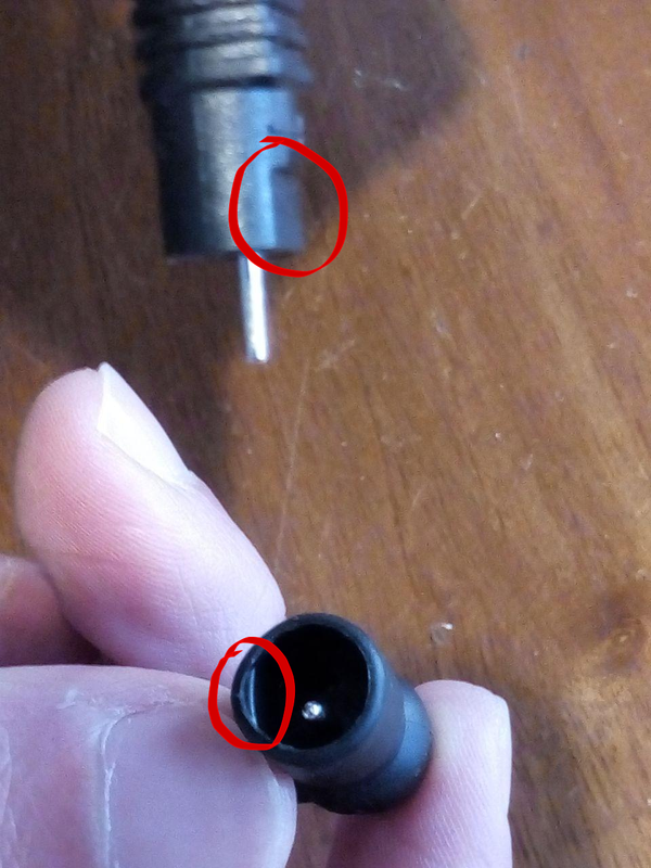

8. check another time the power adapter: -19V (with the minus! WT*!)
9. replace the power adapter: nothing…
Can the inverted polarity of the charger (is it possible?) destroys my charging circuits? They seem integrated in the motherboard. How I can repair the laptop?
Thank you in advance!
Updates
  1. check for continuity in DC-in cable: ok
@jayeff The old power adapter is not original, it is Kraun “Universal Notebook Power Adapter 90W Home Plus“ and yes, it has the polarity symbol with center positive.
The new one is DTK DL90W shows 19V.
OMG I found why power adapter has reverse voltage! The generic connector was mounted in the wrong way!
