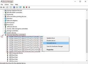

It is quite simple to uninstall and reinstall devices in Win 10.
Right click on the Windows Start button on the left side of the Taskbar and click on the Device Manager link in the options box that appears.
When the Device Manager window opens scroll down to the Universal Serial Bus controllers entry and click on the > symbol to the left of the entry to expand the entry list. (see red arrow in image below)
Then right click on the first USB Host Controller entry and then click on Uninstall Device and follow the prompts.
After this just exit the Device Manager in the normal way that you exit an open window and then shutdown and restart the laptop in the normal manner.
When the laptop restarts it will “find” the USB controller and reinstall it. Hopefully this will fully restore its’ functionality.
You can do one USB Host Controller at a time, which may be prudent and restart the laptop every time or do the lot and just restart it the one time. If you only uninstall the one USB Host controller and then restart the laptop, as you don’t know which USB port that the controller actually handles you will have to test all of them to see if any of them work. Hopefully one will.
You may notice the the laptop is a bit slower when booting up after you restart as it is “finding” and reinstalling all the USB Host Controller that were uninstalled. The next time that it is started it will be back to normal.
Here’s an image to show you where they are located in Device Manager and the options when you right click on an entry. The image was taken from my desktop computer which no doubt has more USB Host controllers than a laptop so don’t worry if you only have 2 or 3 host controllers that you have to uninstall.
(click on image to enlarge for better viewing)
