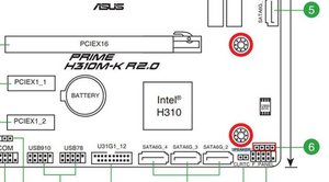

Hi,
Have you checked that the keyboard is connected to the motherboard?
Have you checked that the RAM is properly inserted?
Have you got a chassis speaker attached to the 4 pin speaker header pins on the motherboard?
This will let you hear any beep error codes for POST failure.
Here's a link that may help with this.
Here’s an image from the motherboard manual that shows where it is located.
(click on image to enlarge for better viewing)
