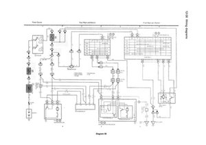

Update (01/10/2020)
added the wiring diagram for your wiper system. Just in case you are running into trouble with the different switch and relay.
My wiper control is type "A"...….delay is non-adjustable. So I ordered a type "B" from Ebay.....which is not difficult to install...….and will allow me to increase wiper delay considerably. -------sailboatjimm
