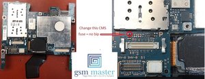

Hello, please help. Backlight on my Xperia XZ2 stopped working. I think it could be blown fuse. But I can't find it on motherboard. Does someone have the picture of it or can help me to locate it so I could test it if it is blown. Thanks

Hi,
you can find fuses in a lot of phones and I think you can also take a resistance of 0k on iphones for example
[image|2046088]
If you want un example for replacement of the fuse
siii podrias poner un ejemplo de como reemplazarlo porfa
Hi, what do you mean by no bip? The circled fuse is the blown backlight fuse?
