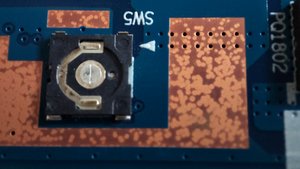

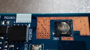

First the powerbutton seems to be damaged
Before :
https://www.noelshack.com/2019-50-6-1576...
Mine :
So I have to take a small aluminium circle that felt from the case to make contact with a circle area in the mobo. When I do that the Mobo start (white led)

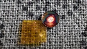

The power switch seems tricky to repair. It seems that it was a little plastic that holds the metalic circle and when you press the power button it makes contact.
Here some pictures
Metalic circle that felt
https://ibb.co/vZgkmwV
https://ibb.co/V2bK1GR
Normal power switch
What I have
By the schematic it looks like a Push button Switch Momentary (On). So you could in theory solder a remote switch via some wires etc. It does not have to be closing the circuit the entire time.

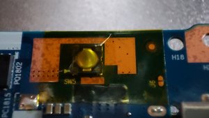

Hello,
Have the same probleme with the power button of my LENOVO LEGION Y520-15IKBN
I open it and here how is the power button on the mother board :

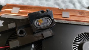

There clearly a missing part that I found on the speaker after my inspection :
And here zoomed :
I put the part back at it’s place :
and put a big piece of capton on it :
Now, the power button is fully operational.
You are a champ, Pascal. Just had one come in with this same issue. Like yours, the part was stuck to the speaker. Ended up being a very quick fix thank to your help.
