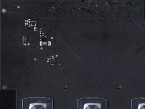

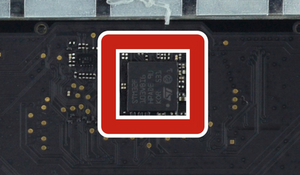

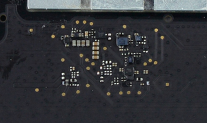

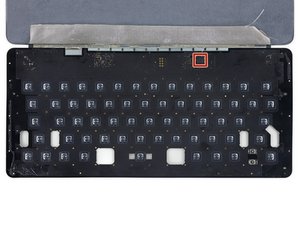

I don’t think your issue is the fabric its self. You may have an issue at the connection points to the fabric if you have bent the keyboard snapping the plastic keyboard base or magnetic anchor plate. As long at you haven’t done that your issue is deeper within the circuitry within the keyboard its self. There are a bunch of components in the top left:
Top center:
And lastly the top right
And here’s the full view of the keyboard:
Unless you have the skills to microsolder these very tiny components (and access to replacements if needed) I don’t think resuscitation is possible for your poor keyboard ;-{
