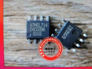

Hi i have similar problem bars and white lines, opened up monitor to check noticed this?
, see chip with red marking looks
Hello, I also have such a problem and want to try to fix it. After correcting it, I plan to describe the result. I found your message and would like to check it, but there is a problem, which is that this chip is an EEPROM (Electrically Erasable Programmable Read-Only Memory), which means that the firmware needs to be written to the new chip. Could you please describe in detail how you solved this problem, or perhaps you already have another solution?
@imortl - Sorry, this is not the issue. As you noted this is an EEPROM chip. The issue you are facing if its the same lines repeating is a timing issue where noise is sneaking into the LVDS signal lines. This kind of issue is always old electrolytic capacitors which have broken down.
@danj thank you very much for the explanation, any help for me is the last hope for repair. please tell me, do you know which group of capacitors on the circuit should be replaced? can I leave you my e-mail and I will send you a picture of the circuit? imortldrumandbass@gmail.com
