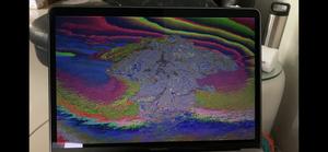

Weird Screen Show up when Shut down
I found some annoy Screen issue when I shut down may MBP
Nov 23: I went to Apple Authorized Shop to check AR Coating issue, They accepted my case to change screen part.
Nov 27 noon: I got my MBP back with new screen.
Nov 27 night: I found this issue when I shut down. So I restarted many times, found this problem shown 9 in 10 times shut down.
Nov 28 noon: I went back to Authorized Shop again to show this problem to staff. They have check and said this issue can not found when Shut down by Safe Mode. It may cause of some software problem. So they suggested to me to format MBP and reinstall OS. So, I Agreed to do that. After 1 Hour for it to finish. I’ve checked many time by shut down at shop. This problem didn’t show again in that time or I came back and use MBP at home. their was no problem in that night Shut down.
Nov 29 night: This Issue came back again!!! I can claim Screen from Authorized Shop because still have 90 days replacing-part warranty but still concern that may damage from other part. My MBP has no Apple Care. and this issue never show before replace new screen.
Update (11/29/2019)
This is my Screen when I shoot clip and capture shut down moment.

TLDR: this is an issue on 2019 and 2020 MacBook Pro devices running Mac OS Catalina. Fools haven’t fixed this even after releasing six updates
Solution:
These are the culprits. Happens randomly even when one of them is on.
1. Turn off dark theme and select light theme
2. Turn off night shift, ambient light sensor and True Tone
3. Change the default wallpaper to a still image(default wallpaper is heavy for their own OS to load!)
4. Change display settings from default to “more space” (or vice versa). The problem happens for one last time and then doesn’t come back provided you don’t change the settings.

Hi Lakshya, that's easy. Just toggle display settings once more and then restart twice

The Apple authorizer told me it is not because of hardware, it is software issue. I talk with Apple Support advisor USA, he confirmed it is Catalina 10.15.5 bugs and he asked me to wait for the next Catalina updates and We still can use our MBP as usual.

Yes, you have a defective part! Time to get it fixed at a real Apple Store if you can. This is not a software issue.
The issue is the T-CON board which is part of the display assembly.

Yes, the issue is the display assembly (which the T-CON is part of)

Accepted answer might be wrong. It's not a hardware issue. It's a bug in Catalina.
On 2019 MacBook pro I was able to get rid of this issue by making a few changes in display settings:
Display settings - toggle between default screen settings and “more space”.
