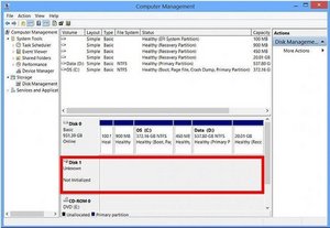

Help would be greatly appreciated! I have a 1tb Western Digital Elements External Hard Drive that is <1 year old, and up until two days ago, was working fine.
There was no physical damage it received. I had the drive plugged into my laptop, I attempted to open a folder on it after some time had passed: it froze, then closed out. I unplugged the drive and re-inserted it: my computer recognizes that something was plugged in, but I cannot access the files on the drive.
There is no clicking noise. It lights up fine, and I can hear the disk spinning smoothly. It shows up under Device Manager under its proper name, but not in Disk Management. When I open disk management, I get a message that says “you must initialize a disk before logical disk manager can access it”. It does not work when plugged into different computers, nor when switching the cables.

if you see something like this:

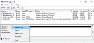

where it says the disk is not initialized, you can initialize it by right clicking on “not initialized” and click “initialize disk” as shown here:
That is what will ruin your chances of recovering the data AND it will probably still not work right. A lot of the 1st party WD externals use Green or Blue drives, which are known to be hot garbage. The newer ones are better, but I'm still leery of them.
Get the data before you erase it.
