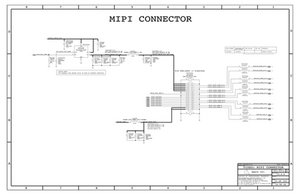

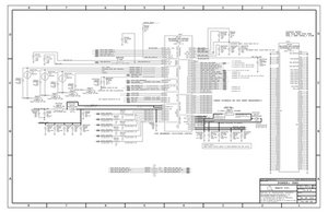

@rechonch0 that is called “Stage Lighting" and can be caused by some of the resistors or coils having failed around the LCD connector etc. You do want to check on those (WLED rails)as well.
