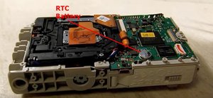

Every time I turn my VR-340 on it has lost its date/time settings. Is there an internal battery for the clock? Where is it? How do I replace it?
wa7jos the RTC (Real Time clock) battery is soldered to the PCB.
Follow this video to get to it
Thank you. Excellent video. I have done SMD rework and have the equipment. Seems within my skill set. Does anyone know the battery number?
