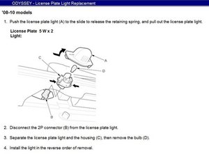

How can I replace the license plate lamps on my 2009 odyssey?
wb5ojw  this from the manual
