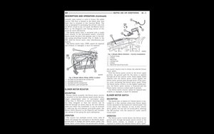

I have removed the cowl and found the hole it is supposed to be located in, but I feel nothing inside the hole. I called the dealership and they told me I should see it again I see nothing inside the hole I feel nothing inside the hole. So please help me figure out the location of the part number RU479 I am trying to install in my Dakota sport.

Here’s a link to the relevant section from the 2000 Dakota Sport service repair manual

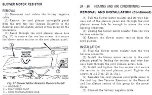

Scroll down on the page in the viewing box to find p.24-3 and p.24-25/26 to view the location of the blower resistor, and the necessary pre-requisite steps to remove and replace the resistor.
Here are some of the pages if you have problems.
(click on images to enlarge for better viewing)
Hopefully this is of some help.
remove dash (at least tilt it back) blower resistor located middle of windshield under dash
