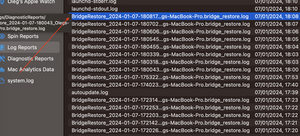

Hey, Recently In Big Sur I mount the EFI partition and DELETED the embedded OS folder just to check the HORROR back again. I was stuck at “Critical Software Update Needed You cant use this……..bla bla” After deleting EFI partition I knew I had to re-install the OS which will rebuild the EFI but some how after Few tries with downloading the critical update I booted in to “ Option+Command+R” combo and for some reason It booted straight in to My Login Screen. Anyone ELSE can try this?
Hey, I just want to be sure for the last time that mine is still in Embedded OS error. in my console if i start streaming it show my console says ‘get info time out’ and “ DFR display Not ready possible Hardware error”. Do you guys also Get that?

I have similar situation on my MBP 2017 (MacBookPro14,3) (waiting for new MBP but still):
  • Cold boot having issues with "Critical update", after pressing retry 3-5 times MacOS is booted.
  • If I downgrade to Monterey- issue is gone
  • If you go into Console app BridgeRestore logs
you may notice that:
  • Timed out waiting for a device to be connected
    • No device found
    • The device failed to go into DFU mode after forcing DFU. Please ensure the EFI Boot ROM is up to date
What bugs me that TouchID and TouchBar are working fine (see #1) but sometimes under "Siri" icon (near TouchID) it's blinking White-brick
