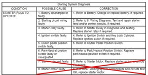

2003 Durango will not crank
my 2003 will not turnover, replaced starter and computer and still will not even crank over. any ideas???
@redneckchef since you replaced the starter motor we are going with the assumption that it is not the issue. Start by checking these things
Here is the part of the SM that deals with the starter etc. Durango-Starter.pdf and the starting system wiring Starting-System-Wiring.pdf
Let us know what you find out.
check all your fuse and swap the starter relay with a relay of the matching number in the PDC (black box under the hood) it sounds to me like your not getting power to the starter
Look for rubbed wire harness going out from the computer and be sure there are no broken wires.
