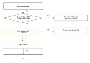

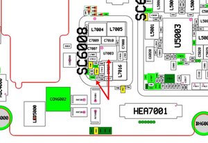

Hello all, the vibrator from my phone galaxy a9 2018 works for about 20mins after a restart then stops. This is very annoying.
Is this common issue?
tonelbg300  that should be a relatively new phone. Before you tear into it etc. you do want to go ahead and check the warranty status first. If it is under warranty get it replaced.
After that you need to check the board according to the flowchart
