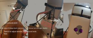

The turning mechanism between the earpad and the headband broke.
After almost one and half year my headphones just broke when I wanted to put them on. I was very surprised that this happened and I'm also very sad because I can't even wear them anymore. The sound and everything is just fine.

ok so I need the part that's still connected to the earmuff... the plastic piece with the 2 screws on the bottom of the first picture
Floortje B  the only way you can fix that is by either having someone 3D print you a new part for it or you’ll find another pair that is broken other than the hinge part. Looks like the 2 screws are the only thing that hold those to your headphone. Removing those most likely enables you to replace the broken part.
I figured out a temporary fix. I am posting this for others arriving here from search engines and the like. I assume OP's problem has long been solved. My fix is based on somebody else's fix.
I have 3D printed parts on the way, but my 'design' may actually press down on my ears better than the original. 🤔
What you'll need:
-Tie rip 2 mm
-Tie rip 4 mm
-Drill + 1,5 mm drillbit for metal
-Strong thin elastic.
-Pliers (for making sure the tierips are real tight.)
Alt for picture: https://imgur.com/a/TcRGRT2

My device is broken exactly at the same point today. I fix it by drill a hole from one site to the other (1,2mm thick) and insert a steel pin (as it is used in watches). I used black tape to prevent fall out of the pin.
