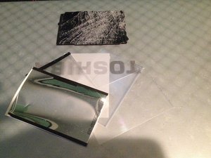

^ finally someone on the right idea. there's a !&&* of a lot more than 2 layers to a touchscreen. this is a broken 4s screen right here - that's 5 layers in addition to the "glass" that's still glued to the LCD.
The Bottom part of your picture is the Back-Light assembly that is under the LCD to light it up so you can see it. Mainly Diffuser sheets...a multi-layer, semi-transparent plastic sheeting to help spread light evenly across the lcd... but not part of the actual LCD assembly
