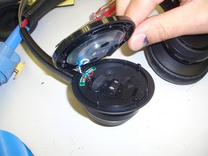

Has anyone figured out how to open the headset to access the battery for replacement? Replacement batteries seem to be available https://www.ebay.com/c/10013570523 but I have no idea how to open the headset.

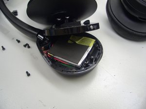

A bit late I know , but I've just taken mine apart due to the same cracks and it looks like you cannot just change the plastic sides as the cables all pass through and are soldered to a pcb for each earpiece.

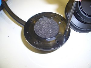

These photos were very helpful but let me add that there is a sticky piece of rubber that holds the foam. You can peel it off by getting a razor knife under it. The rubber will peel off easily once you get under it.
You can use rubber cement to hold the battery in and also the foam when re-assembling it.
Also, keep in mind that the battery leads are VERY small: you will need soldering experience before attempting this replacement.

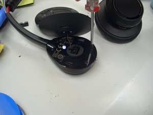

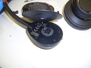

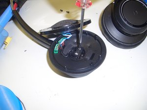

It comes apart in layers. Here are the pics. The Black leatherette cover of the earfoam just pulls off from the backside of it..just be careful!

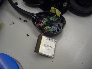

First of all, many thanks to jnesoff for the pictures. They encouraged me to change the battery because my headset only lasted about 2 hours.
But I made one mistake and I'm writing here to make it a little easier for others. My comment refers to the first picture. I tried to take the foam off and ended in cutting it into small pieces. In the process, I noticed that this is not the right way to do it, because the foam has a backing film that can be quite easily removed from the headphone housing in one piece. So when you are in this step, don't go between the foam and the backing film with the cutter knife, but try to get hold of the backing film and remove it straight away.
I was able to find the battery easily on ebay (Germany) - I'm sure it's also available in other countries. The part number is AHB403029.
Take pictures of the individual steps with your mobile phone, it helped me during assembly.
If you have the tools at hand, the whole thing can be done in about 30 minutes.
Good luck.

Very useful instructions, followed to the letter and worked perfectly. My battery was also only lasting about 2 hours. I found a replacement on alibaba, installed in about 30 minutes. From fully charged it’s now lasting about 14 hours!
Yo Marc, thank you for the tip about the foam having a backing film! That definitely saved me damaging mine.
Be careful when working down through the layers, as there are cables running through the middle which you don’t need or want to disturb in order to access the battery.
Replacing the leatherette cover is relatively simple (as long as you haven’t damaged it in removal, I suppose) - just turn the thing inside-out, place it over the earpiece and roll it back the right way out while in position. Then the edges just need gentle encouragement to sit in the slot neatly.
One more thing: the photos don't really show which side of the headset holds the battery. It's the side opposite of the microphone.
