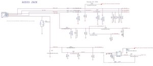

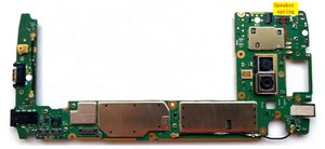

My Moto g forge phone only has sound with earphones. There is no external sound. Can this be fixed ?
Rhonda Huffman  it is entirely possible that this is caused by a bad headphone jack. It may keep the circuit closed making your phone “think” that the headphones are still connected. Insert and remove your headphone a few times in quick succession. you can also use some “canned air” and try to blow out any dirt, dust debris in the jack. If that does not work you may have to disassemble it since you may then be looking at either replacing the jack or your speaker etc.
